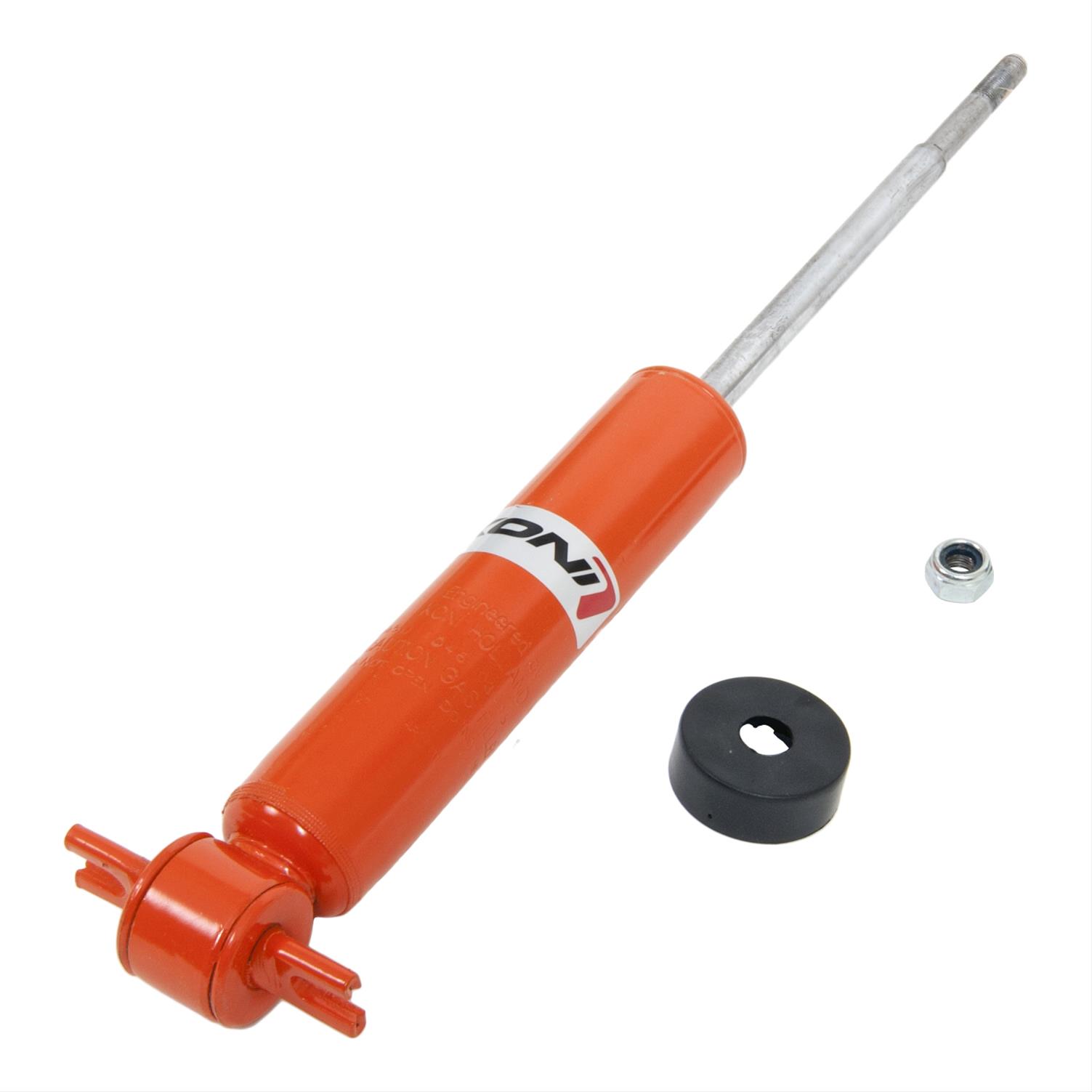

Pretty specific question but I didn't realize Koni had a shock specifically for lowered cars, I went with bilsteins but gotta say the ride does not feel good and I think it's due to how lowered my car is and how compressed the shock is just at ride height. I couldn't find any info on the bilstein compression/rebound ratio but the Koni Streets are 35/65.
When I did my suspension overhaul I ran Canuck 2/3 drop springs, at the time everyone said Bilsteins was fine with the lowered setup so I went with it but the ride quality has just not been that great to be honest.
As mentioned in this video it has a pogo stick sensation.

Koni says their shock is specifically valved and designed for your car. Yeah right ,then listed for any car it will bolt into, including an Avanti !!

From personal experience those Koni STR.T Shocks suck.
I had them on my lowered '96and they were so rough and mushy, didn't feel planted at all.
Swapped them out for Bilstein Sport within a year and the ride was much better and way more planted and stiff.
Looked at the Koni after I took them off and two of them were blown. and they're about half the diameter of the Bilstein.
Not sure if that helps, but I do have real experience with both brands you're asking about
