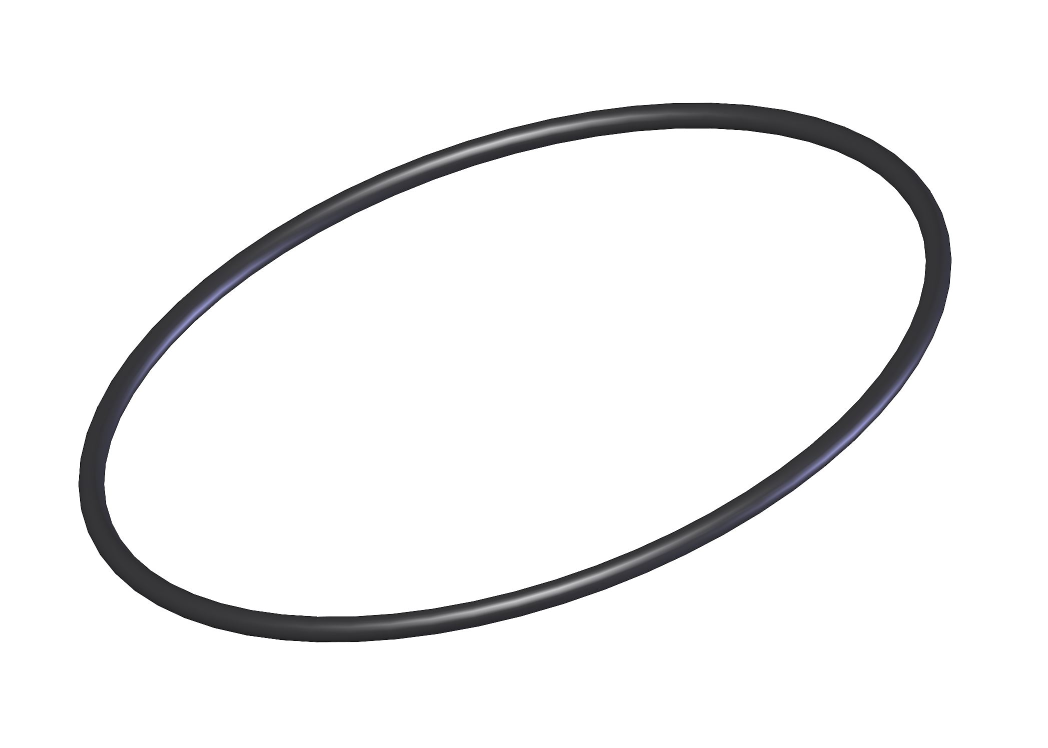

When I'm doing big maintenance on LT1s, I always take the six bolts off the water pump cover and make sure the impeller is tight on the shaft and in good condition. I've had three water pumps now, both new and used, that have leaked from that cover afterwards.
There's a very thin o-ring in there that's supposed to seal it. Should I augment with something like Right Stuff or Hondabond? There's plenty of machined flat surface for this sealant to work with.

My industrial catalogues show "make a o-ring" kits.
My understanding is you cut to length then glue it together. (super glue?)
Has anyone used these kits?
If the o ring is OK maybe a small amount of coolant safe rtv in the o ring groove would seal it.
Are the electric water pump suppliers providing new o rings?
Would they sell one outside of the kit?

From a quick search:
The parts CD shows a seal, water pump cover (O-ring) 11508805.
GM #10128329
I am not sure which is correct.
Edit many references to GM #10128329
My cheap HF calipers say the pump diameter the "O" ring needs to fit is 3.565" and the ring is .100" thick (round)
IIRC the O ring does stretch slightly to fit so 3.560" should be fine
3 - 9/16" overall diameter; one hundred thousandths thick. Roger.
Dash 153 by my observation. Cost is $0.24 for two in the 70 durometer nitrile.
The cork seal?
that seal is a cork holds that cover on damn tight. That leads me to believe that seal is doing its job. However, not all OEM/GM re-popped pumps have this seal on it.
A smear of rtv on the cover may work.

Have made O rings , yes
Have an local Seal- O ring warehouse that almost always comes up with what I need .
Hylomar would be my go to for a questionble sealing O ring I was stuck with.
Non hardening and fuel proof too
