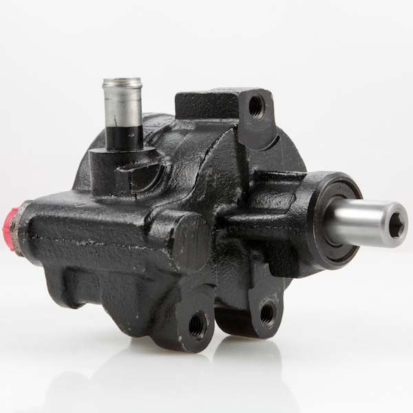

Gents,
I have had a local shop around here (very trustworthy) install a new power steering pump (remanufactured) into my 1995 Fleetwood. We have deleted the electronic nipple/needle that worked with the electronic steering sender as it was causing issues with heavy steering, as you all may have remembered from an older post.
The shop put a slight bend in the OEM power steering lines to have the lines fit directly into the pump, rather than change over to a Caprice pump and Caprice power steering lines. There is not any impediment to the flow of fluid due to this.
Across 2 different shops, I am now up to 3? 4? (2 Autozone pumps, and a couple of other brands) power steering pumps as they keep whining, and causing the car/throttle bog at low speed. Steering is very difficult in parking lots, etc, and the car will sometimes bog at start up when goosing the throttle and turning the wheel as you leave a driveway or parking spot.
They have installed numerous pumps and warrantied every single one, so I haven't paid a dime for the extra work.
That said, does anyone have any grand ideas as to what is happening and why they would be failing so frequently and quickly? Terrible manufacturing? The belts and everything are in good order to drive the pump, so that doesn't seem to be the issue!
THANK YOU in advance.

#7 ·
Thoughts of top of head,
What fluid are they using, if ATF or some off brand ps fluid , not the best choices. Guys have had good success with synthetic steering fluid.
My go to is still conventional GM PS fluid.
Are they flushing system till clean.
( cranking wheel lock to lock while flushing helps)
Does the shop have the tools to do proper pressure AND flow checks ?
This to make sure the momentary boost loss you seem to be having is pump, not box.
High box internal leakage from seals or wear can cause stalling of PS.
Typically, but not always worst cold.
"Morning sickness" as it is known.
Vacuum bleed ? Has been helpful personally with trapped air, and resulting foaming-whining.
With all your issues, I would personally have a magnetic filter on your return.
Example
Not saying the above is your issue , more possibilities.
Good luck
#8 ·
Something is wrong with your system. Power Steering pumps are very simple inside. The behavior you mention sounds like the high pressure line is constricted.
Having both a roadmaster and an Impala at my house right now, the line in the back is ninety degrees different between the variable assist and non-variable-assist, so a "slight bend" is like saying I "slightly totaled" my car. How do you know the line is flowing properly? Did you measure it or did the shop measure it?
I'd say replace that line with a proper one FIRST. Then go from there.

#36 ·
Gents,
first post long story...
So, what I heard you say in your first post is:
  1. Shop removed the electronic control solenoid from rear of power steering pump.
  2. Shop modified the existing line to fit a regular outlet.
  3. Symptoms:
    1. Pumps whining
    2. Car bogs at low speed.
    3. Steering is very difficult in parking lots
    4. Car will sometimes bog at start up when goosing the throttle and turning the wheel as you leave a driveway or parking spot
  4. Multiple power steering pumps have been tried, same symptoms.
I suggested that it's highly likely that the "modified line" is causing a flow restriction. Since a new (and correct) line is cheap and not terrible to replace, I'd replace that first. I did not give a next step after that.
Sherlock, I wanted to touch base again on this. Isn't it the case that many classic car owners make custom power steering lines and bend them in all sorts of crazy fashions with no ills effects?
So the bend itself isn't necessarily the issue, it's that the shop that bent it, probably caused a restriction within the line (that's not visible to the outside).
Based on what you're saying, there is 0% chance we have a gearbox issue. The pumps that have been installed have all been garbage (in my opinion) and the line probably doesn't help. The system is a very simple one. I've been told the tensioner is working correctly and the serpentine belt is brand new.
So based on that, it's almost guaranteed it's the line somehow.... Correct?
Yes, it is the case that custom hydraulic lines can be made. Every time there is a bend, there the potential for a kink. There is right and a wrong way to bend hydraulic line; at this point pipe bending is well understood.
It is very possible that the additional bend added by the shop caused a restriction. 95wagon asked you to flow-test the line; I suggested that you should replace the line because it was cheap and relatively quick, therefore a good first step. Have you done either of those steps yet?
By suggesting the line first, I was starting with the cheapest / easiest / most obvious potential cause. The next cause would be the steering box itself. The steering box is both more expensive to replace, and more complex than a power steering pump with more variable quality among rebuilders. But since you hadn't yet replaced the line, I hadn't yet recommended a next step.
I also refuse to believe you have had four bad power steering pumps in a row. I personally have rebuilt 6 power steering pumps. 5 of the 6 worked perfectly; only one would not build pressure and I never did figure out why. A parts store rebuild pump was later installed to replace it and it worked instantly. Again, they are a simple part.
#38 ·
  3. Symptoms:
    1. Pumps whining
Thanks for the long and good reply.
I don't mean to make this long in the tooth just trying to make my mark and strike and do it all at once.
1-4 are all correct, yes!
The problem is that since the electric solenoid has been removed, the OEM line no longer works in the OEM pump (minus the EVO). So the Caprice/Impala line will probably not work, either since the Fleetwood and Caprice have different locations for hookups. I can't just replace the Fleetwood line since I no longer have the EVO. I am stuck in this middle ground.
*At this point, my only way out (I see) is to replace the high and low pressure lines with Caprice ones and install a Caprice/Impala pump. That way we know that all the lines and fittings and pump are 100% OEM. Anything other than that is a half measure. * Am I wrong here?
I have not flow tested the line as the one shop that was supposed to do it failed to do so among other emergency repairs (leaking coolant hose).
I spoke to Lee Power steering about the gearbox and they think there is VERY little chance the gearbox is the problem. They agree with what you're saying about either the pump or the line.
#48 · (Edited)
You removed it and put in one of these , right ?
I agree with you 100% on the pressure test! None of the shops I have taken it to have pressure tested it, included the one that's warrantied my pump. Their assertion is that it's a new pump, so pressure through it should be fine. Hypothetically, yes but as we know most likely the line is causing us issues which would show up in a pressure test.
The shop did the original work, but yes the EVO is gone.
I go back to my original question: I can't just fit the Caprice hose into the Fleetwood pump, can I? The lines won't line up perfectly since they weren't made to be mated.
The only way to do what you're proposing is to install a Caprice line and a Caprice pump, correct?
I can't just go put a Caprice line with an Impala pump since they don't line up properly?
#45 ·
Buy a pressure hose by application for a Caprice or Impala for the same year ( yeah I know its not a model deal but Caprice -Impala never had the option so it is,easier to get correct hose by that application )
That will remove the question whether or not the modification of your original line is a contributing factor.
I still stand by my original post , that your shop needs to do PROPER PS system flow and pressure checks.
#49 ·
An impala is a caprice
I was trying to simplify this for you but it just got worse.
Buicks can be had with or without the variable assist so referencing doesnt help.
Caprice- Impala NEVER had variable assist .
So , if you ask for pressure hose to fit a Caprice , or Impala ( same thing) you will be getting a hose that fits the pump without the solenoid in place.
Physically, fitting the 94-96 ( the whole car line ) the pump casting is the same.
Same as all the boxes from a hydraulic fitting respective.
The pump, if you have the short, non solenoid, nut,
( I'm not going to refer to it by name because you will just get confused more)
the caprice- impala pressure hose will screw into it.
#52 ·
Thanks for sticking with me; I'm sorry I am so slow.
I'm with you on the differences between the vehicles.
I'm not sure if the shop installed that plug like you've shown above. I assume they did, which is what required them to put that bend in the OEM line in the first place.
So you're saying if that plug has been installed, then the Caprice line will fit right on there and I'm off to the races. No reason to install a Caprice pump then...
This is a pressure hose for the non variable assist , caprice- impala.
View attachment 200055 View attachment 200056
Interesting it still has the pressure sender on the line....
The linked article above shows their new line and they took it off... personal preference?
200058

#53 ·
Read over this thread carefully.
The switch in the line that is closer to the box,
(You can also see it in the photo of my hose I took 10 minutes ago)
has nothing to do with the variable power steering system and the solenoid the shop removed from your car.
If yours is there and solid, sure move it to the new hose.
If yours leaks , then don't bother.
If you make a habit of cranking the wheel standing still ,in gear ,dead idle, AC on then you might need it.
#54 · (Edited)
@95wagon I FINALLY SEE IT:
Cadillac pump:
200059
Caprice Pump:
200060
With the EVO removed and the straight adapter in there it's the same pump🤬
Caddy:
200061
Caprice:
200062
That little doo-dad will control idle. No real habit doing that... Don't think mine is leaking but I can have a looksie and see.
I understand what you're saying now.
Thanks for sticking with me on this. Difficult and I'm a bit slow over online since I didn't actually do the work myself on this job.
The low pressure line is 1:1 the same thing across all B/D body cars regardless of variable assist, then? Caprice=Impala=Fleetwood?
#55 ·
There you go,
If you unscrewed that 1" hex on the chev pump and removed it, "poof" that pump essentially turned into a caddy pump waiting for you to put the solenoid in.
Stuff that hex piece and internal bits in the caddy pump and again, "poof" your caddy spec'd pump turns into a chev pump.
So to speak,
That switch in the line tells the ac to disengage
( think we covered this 🤔😉) above a given pressure.
Its not like the IAC wouldn't try to keep base idle but dropping the AC helps it react to instantaneous load somewhat.
This is why bluehairs parking their caddies are sweating in the summer
#56 ·
Finally makes sense. They MUST have used that adapter in my Caddy pump... Never mentioned it to me but they had to have to get a line to work in there. I wonder where they got that little hex piece from to install....
Interesting... Without that little secondary device on there the AC would go go go and if I was really wrenching on the wheel would be low idle. Cut the AC, raise the idle.
