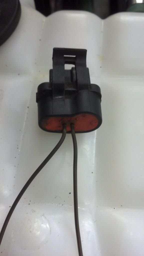

This is the connector for the alternator. I had to replace mine and need to know which one is positive?
#3 ·
The one on the right should go to the wire that is ign power from secondary fuse 10 amp
To be more exact,
The terminals on your alternator plug are , starting with the large terminal, S,,, F,,,L,,,P
Our cars only hook up F and L
the letters are on the alt and should be on the plug
F goes to secondary fan relay fuse in the under hood fuse box and should be powered when ignition is on ( test to be positive by pulling fuse with test lamp hooked to the wire)
L goes to the instrument cluster

EDIT - Just meter the wires back to Fuse 8 and Fuse 11 and figure out which wires goes to Pins F & L in the Connector. Check those fuse locations in the Schematic, it looks like Fuse 8 is in the Under Hood Fuse Panel and it looks like Fuse 11 is on the Dash Fuse Panel.
